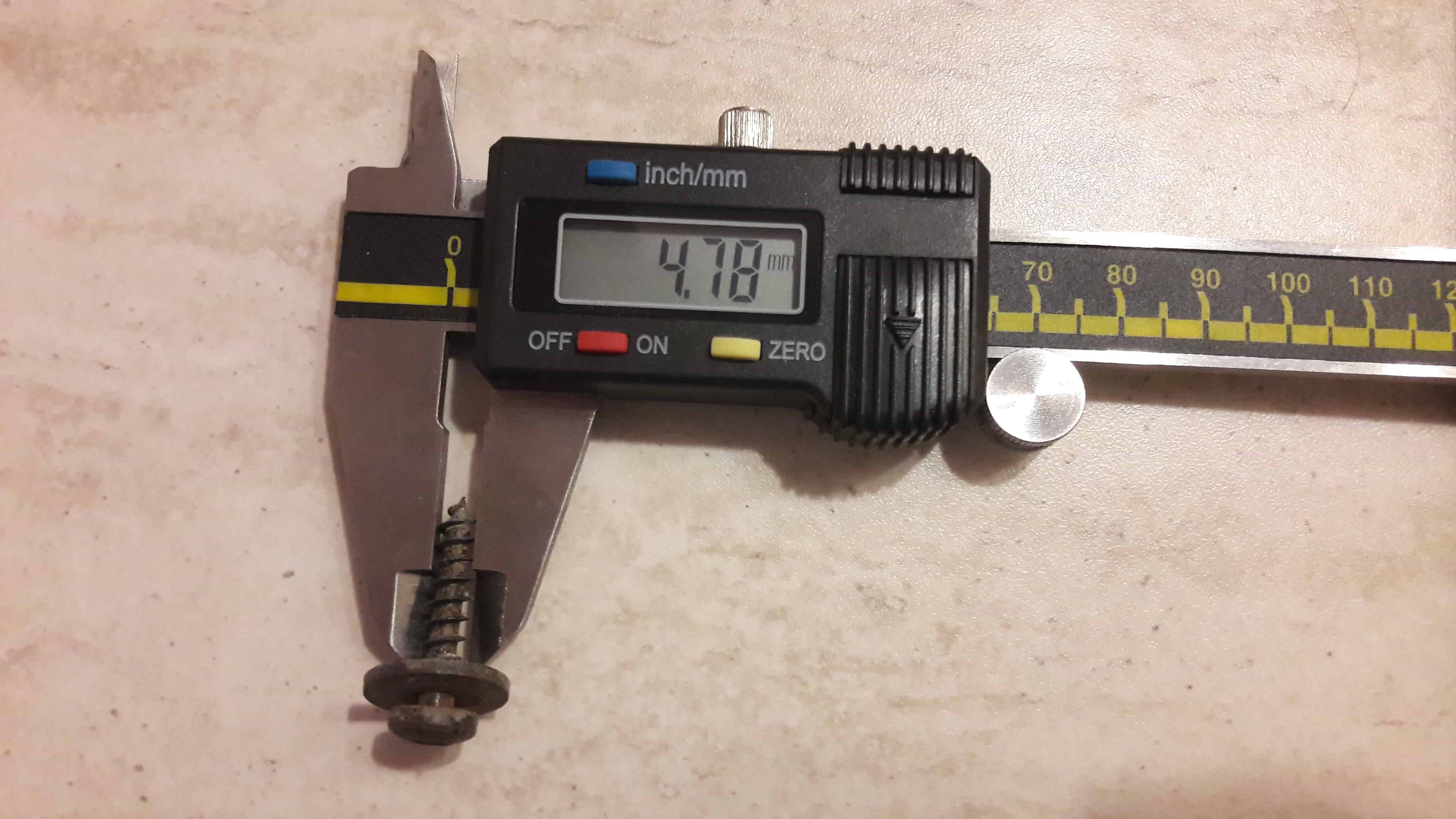

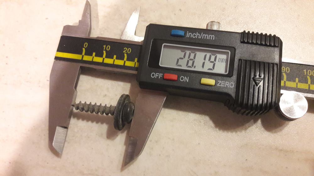

@apashi vezi la ceva magazin de bricolaje de suruburi autofiletante similare, cu pas mare si ceva saibe.
Orientativ, valori masurate pe suruburi de la aparatori date jos de pe masina, in mm:
Lungime 28, grosime 4.8, pas 3.5, latime saiba 16.5
20170902_234906.thumb.jpg.81fd758b44fcf6744c6176aadee283ab.jpg20170902_235007.thumb.jpg.ceb112e84d321223590ce5414668e7a7.jpg20170902_234946.thumb.jpg.de2420aebc0a990fabccab3e4792511c.jpg20170902_234835.thumb.jpg.64b0dceea485114b05ad2f7c34a7fccb.jpg
Sper sa ajute.
