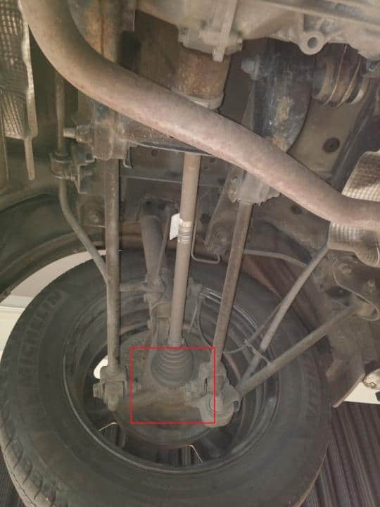

hello there.
so after some time i managed to post an update to this - sorry for delay :-). i have my car fixed now, but it took some time. i have been using it with that ABS/ESP malfunction for almost half a year (no serious issue for me anyway).
the problem was a crack in iron gear ring near wheel on the left rear axis (see attached pictures). this piece is used to determine how fast the wheel is rotating and this information passes to the control unit. as far the readings from sensors were faulty, the control unit turned off some drive assistance electronic systems.
first i have tried to fix it in dacia service, but they proposed to replace whole halfaxis (this was the smallest possible replaceable part available to order) and estimated total cost of repair to about 500 eur. this is way too much money for fixing such small crack in simple iron ring. So i decided not to fix it for the moment and ask few guys around to give me a hint for a clever mechanic. i found one and he was able to machine this part from a raw iron plate in one evening (costs me 60 eur). the ring was replaced and since then i am having no issues for more than 1000+ km.
i hope this could possibly help some of you with similar problem like i had.
have a nice drive,
Juraj
