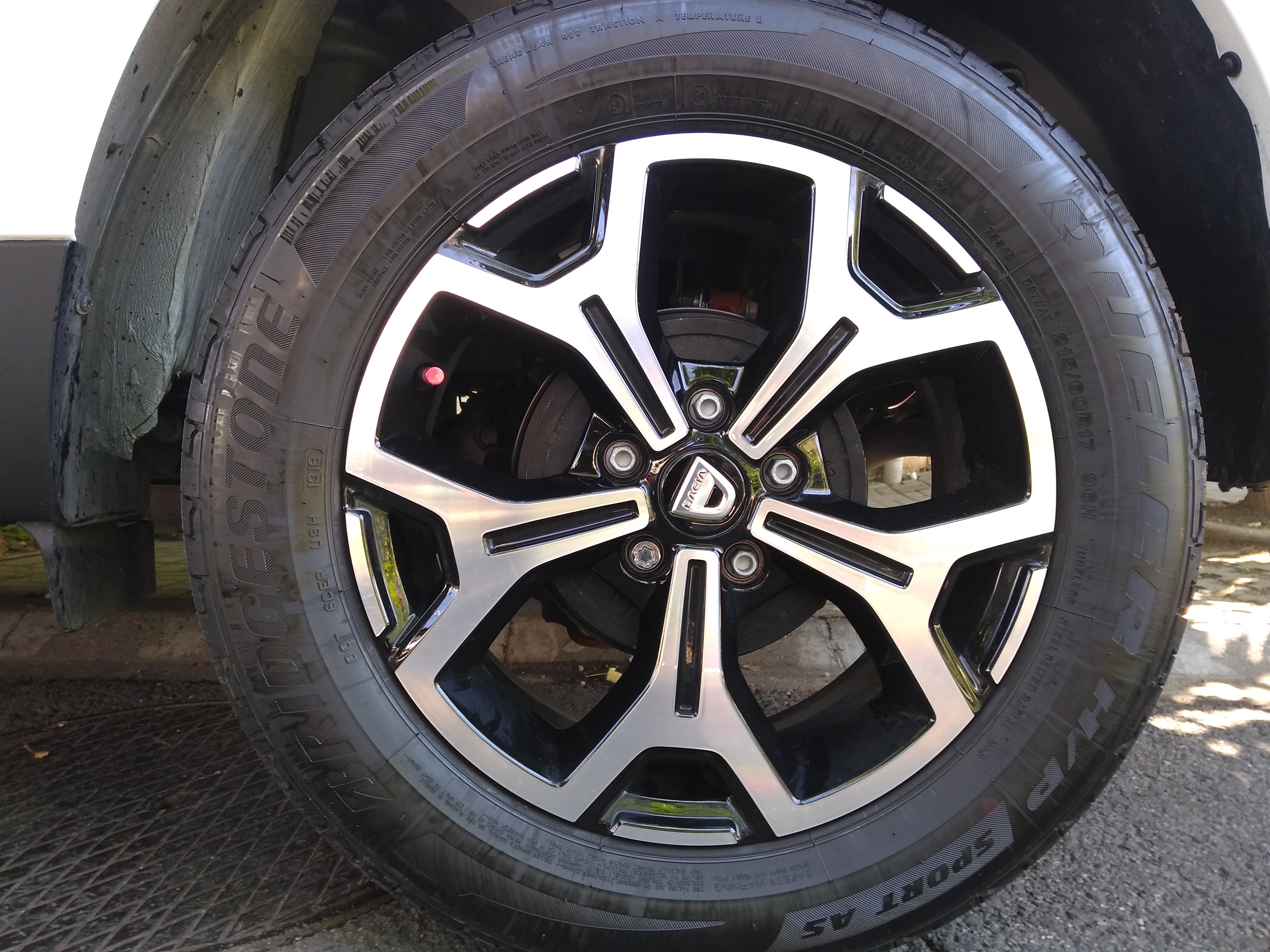

Vand 4 anvelope Bridgestone Dueler HP Sport AS 215/60 R17, all season, DOT 2018, utilizate cca. 15000 km, stare excelenta. Pret 250 lei/buc.
